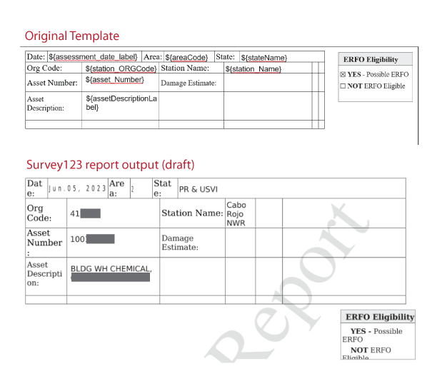

Does anyone know where I can find a reference for a workflow or good practices for creating a word template for a syrvey123 report? I try many different ways for creating a custom template in word using regular outline, tables and text-boxes and every time I upload the template, the survey123 report engine change the layout  or order of the content on the output (see example below). I can't not get to work . Any suggestions?

Have you tried generating the report in word doc format, even just once? I know it costs a tiny bit of credits but sometimes you have to "swallow that" for testing....when generating a sample, it can be good to test and see if data is populating the correct way but it messes with the table layouts a lot since margins aren't the same, or something similar going on with the samples that get produced.

Thanks Katherine,
Thank you for the suggestion!. You were right, It does looks 99% similar  to the original template when I generate  the report that cost credits.  The PDF still look bad. There are now a bunch of other problems but at least I solved one. Thanks once again for your time!
