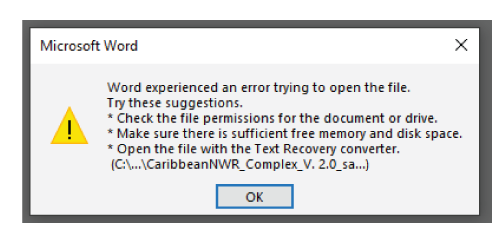

I am having hard time creating a report from survey123. First, I'm trying to just get a sample report using the the "individual record" template but it won't open on Word. I'm getting the attached pic error in word.

Regarding the word issue: did you try this yet? https://support.microsoft.com/en-us/topic/how-to-resolve-the-problem-word-experienced-an-error-tryin...

I forgot to mention that the issue with word not reading the sample template created by survey123 still not working for me. The MS link suggested by Nicole does not work to solve the issue . I still unable to open ANY sample template (individual record or Combined) created by syrvey123.

Sorry to hear that the MS link didn't solve your issue. Do you want to try the attached template? It was only downloaded not further manipulated in word. (It belongs to a quiz in case you wonder about the questions.)
Did you try a different browser yet? Tech support's favorite advise is clearing the cache 😉  Did you try yet to open the file from a different location?
JoseBarrios1
Thanks  Nicole,
The file that you attached opened without any problem! I'm not sure what it is going on with the one I created! I did try to download the file with Chrome and Firefox and from different location.
Nicole_Ueberschär
Really strange. Is it only for this particular survey or is it happening for all surveys? Do you have (by any chance) another subscription where you could try downloading the template?
