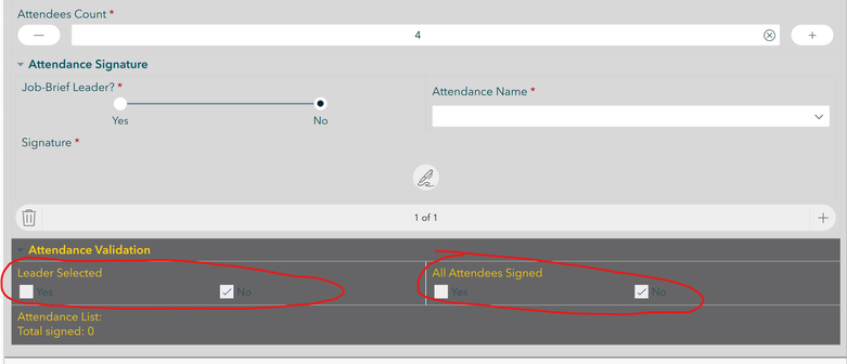

Hi,
I have a Group that I want to change the color of the fonts. The body::esri:style parameter only allows the background and border colors to be set for a group.
I tried to use html (<font color=###> or <div style="color:###">) in the Group label and the questions inside the Group, but that only changes the color of the label but not the options on select multiple questions (see images below).
Is there another option?

If you want to change font color for a select_one/select_multiple list, you need to do so in the label on the choices tab. Also, you cant use modern HTML (e.g., <div>), you need to use old HTML (e.g., <font>):
For example:
EDIT: Be aware that these HTML tags will appear in your Feature Report. If you want to drop these choices into a Feature Report, you can't do a simple ${example} and expect to get "No". You need to do ${if example=="no"}No${/}${if example=="yes"}Yes${/}

Hi abureaux,
This worked perfectly for me. Thank you for the thorough answer, especially the Feature Report warning.
