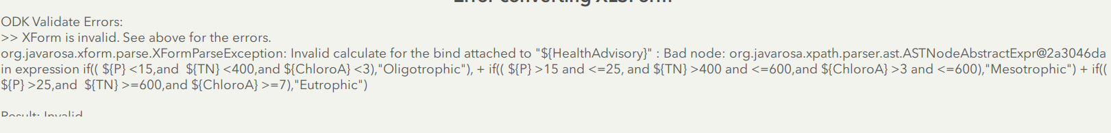

EDIT:
Here is the error I keep receiving:

Hi Michael,
You can not mix and match the if statements with mathematical operator such as + sign. You need to use nested if statements or re-write your expressions to use AND operators and put brackets around each part in your expression.
Phil.

So I've seen the nested if-statement suggested multiple times and have now moved to this:
if(${P}<15 and ${TN}<400 and ${ChloroA}<3),"Oligotrophic", if(${P}>15 and <=25, and ${TN}>400 and <=600 and ${ChloroA}>3 and <=600),"Mesotrophic", if(${P}>25 and ${TN}>=600 and ${ChloroA}>=7),"Eutrophic")
However, I'm still not having any success. I think my parenthesis are off, but cannot figure out how...
JamesTedrick
Esri Esteemed Contributor
Hi Michael,
The if() statements need to be nested within each other.  For example, if you wanted to determine which school type a student was in by grade (1-6 Elementary, 7-8 Middle, 9-12 High), we can break this into 2 if statements:
1) is the student in an elementary school
2), if 1 is no, is the student in middle school
If 2) is no, we know they are in high school.  This gets implemented as
if(${grade} <=6, "Elementary", if(${grade} <=8, "Middle", "High"))
Note that at the right end there are 2 right parenthesis - one for each if() statement.  Also note that I can remove the check in the second if() for grades 1-6 - we already addressed that in the first if() statement.
In the formula you have above, you have the evaluation criteria (for example,  ${P}<15 and ${TN}<400 and ${ChloroA}<3 ), in parenthesis by itself - the true and false values also need to be inside the parenthesis as well;
if(${P}<15 and ${TN}<400 and ${ChloroA}<3),"Oligotrophic", <Mesotrophic/Eutrophic IF>)
would be the first, with the next if statement in the <Mesotrophic/Eutrophic IF> area.
