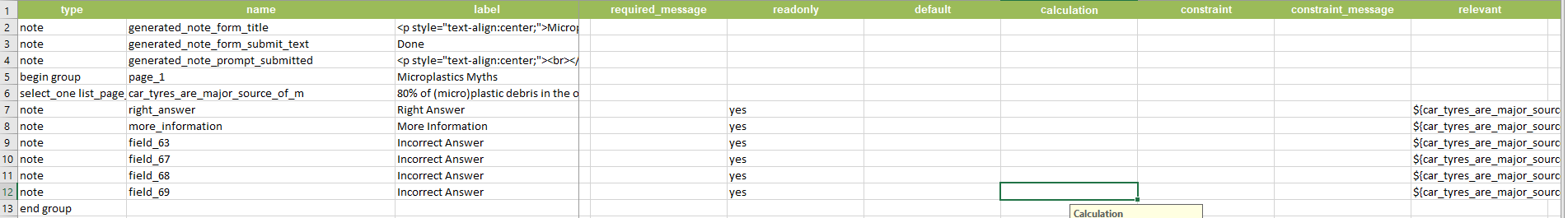

Here is how a single question is made in the excel sheet:
What's the best way to implement this? In the end i want to show score for each question and a total score for the whole quiz
