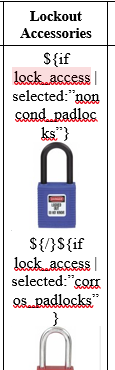

In my Feature Report, I use IF statements to dynamically show the images (which are stored in the DOCX)

As far as I am aware, you can't pull something from S123 media folder and use in a Report Template. However, you can add images to the report template and have them dynamically shown. You would just nest the image inside of an IF statement.
JoeBryant1
LOL! I was not making this logical leap! You can paste the image right into the doc in the conditional statement the same way you enter a text string. No calling of external media required. And you can get the format/size perfect without having to guess at pixel width.
That is better than publishing the image as an item in ArcGIS. Thanks for pointing this out!
I'll mark this as the solution with the clarification that the answer is "No, you can't access the Media folder from the form, but you CAN do this."
