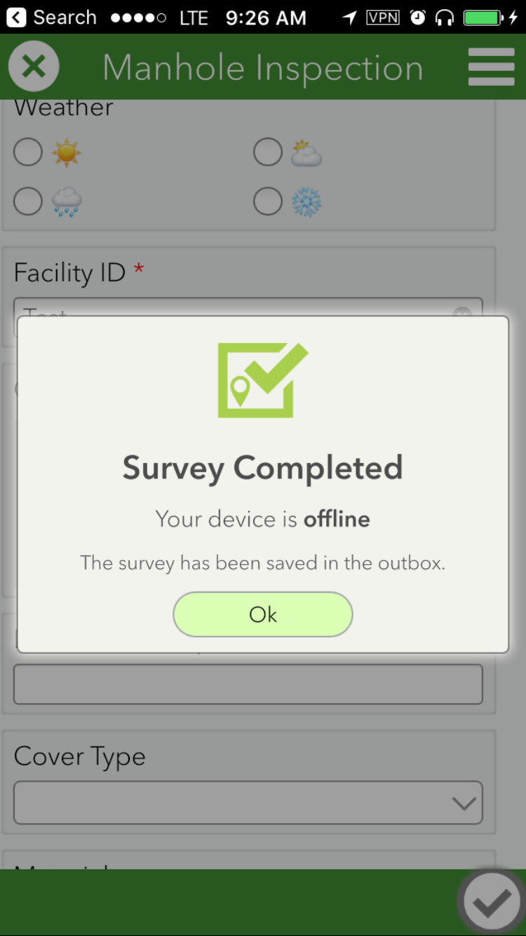

Using Survey123 version 2.1.6, on iOS, connected to Portal 10.5, and using per App VPN, I am able to login to the Portal and download surveys; However as soon as I try to submit the survey the App reports that it is offline.  Once this offline status is reported the login menu disappears.
How does the Survey123 app check its online / offline status?  Is the check repeated?
Survey123 reports Offline with LTE and VPN.
