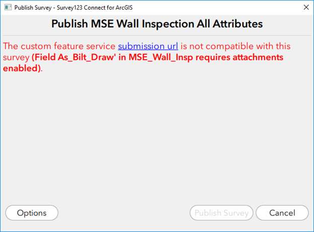

I am getting the error

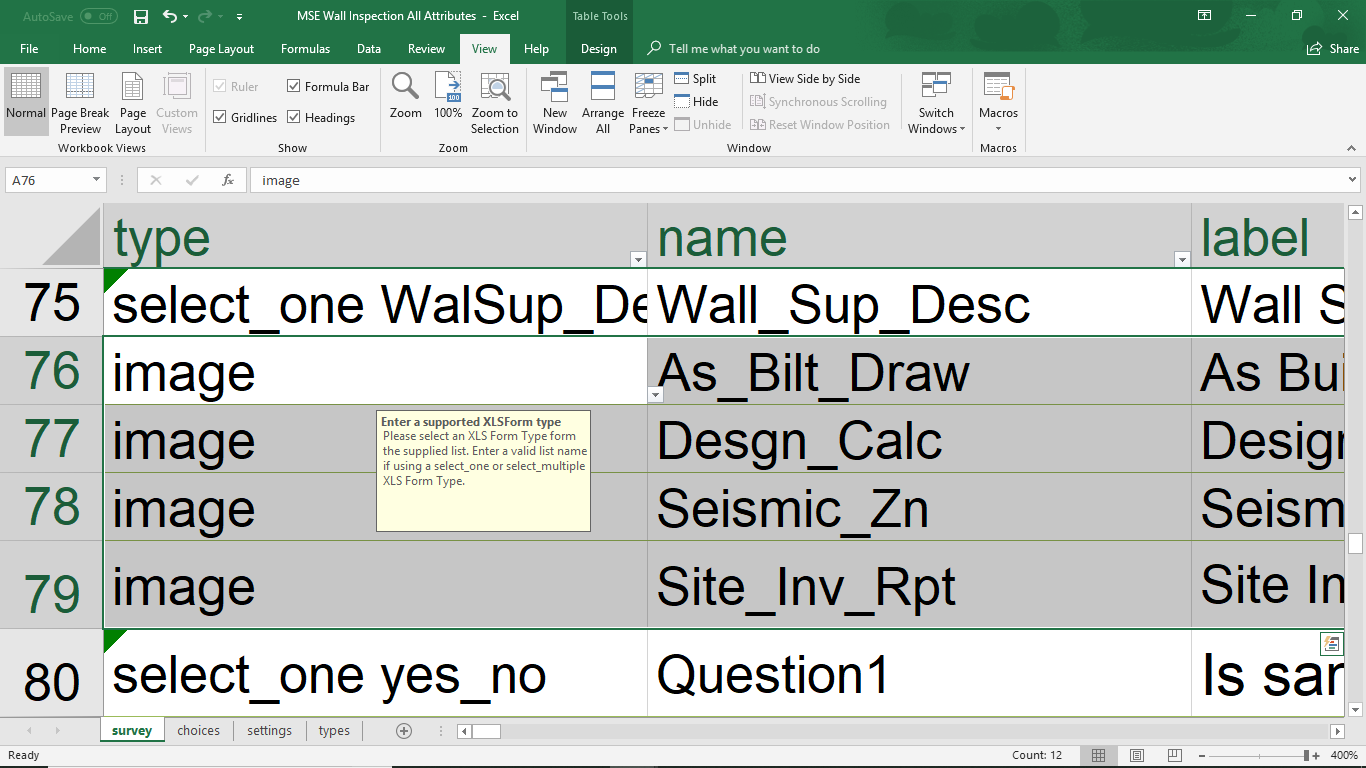

These are fields I am trying to add with images or PDF.
How do I set this up in ArcGIS Pro so that when I add this feature service I can import it to Survey123. These features were original "text" in my feature layer just so I could get them imported into Survey123. After in Survey123 I changed them to image. I then tried to publish it and then the error above was displayed.  Send me a video on how to do it I can not understand the text responses very well without a reference video. Thank you.

Hi there,
To enable attachments via ArcGIS Pro, you will need to stop the service, run the Enable Attachments—Data Management toolbox | ArcGIS Desktop GP tool, and restart the service.  This service should detect that attachments have been enabled.
CCHSBobcats
Thank you. I also went to the layer in ArcGIS online (Item Details) > Overview and seen that the layer itself needed to be enabled.
