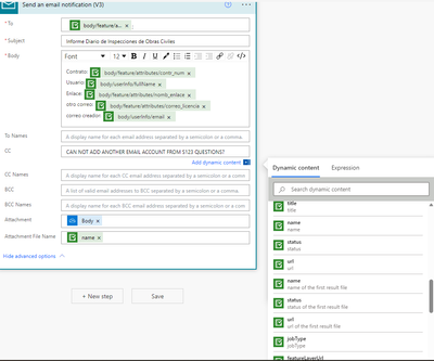

I created a Power Automate flow to send a report every time a field survey is completed.  It is working but only send the email to the “S123 Creator” account user by using the "email question” variable value.
On the CC there is no option to select another "text question" that has a variable value of username@companyname.com or supervisorname@companyname.com.
I want to send email reports not only to the "S123 Creator" but also send to others via CC to the field personnel that created the report (maybe he or she wants to do some editing before the final report) and, also a notification to the supervisor of this person that might be interested in learning what´s happening in the field.

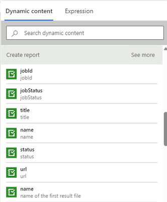

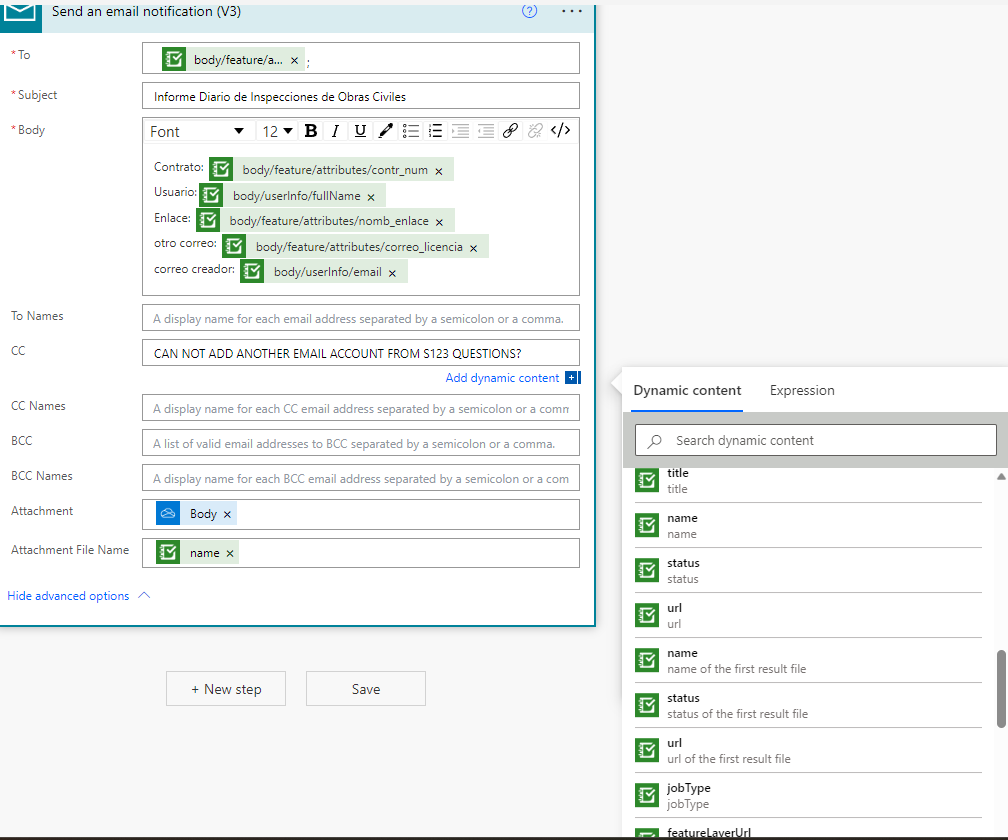

Thank you for your recommendation, however I tried that solution within the S123 form.  See the highlighted (in yellow) rows.  I aso tryed with an email question, but this type of question seems to use the Creator of the survery email address.

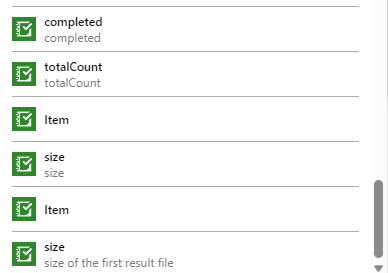

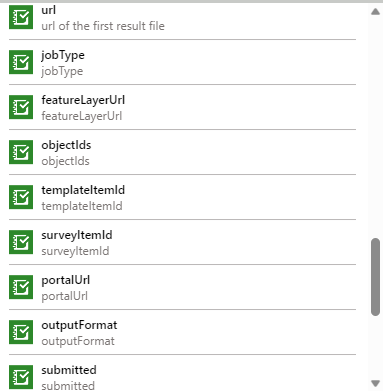

Seems so me the problem is how Power Automate recognize those fields in the "Dynamic Content" pick up table, and these other "questions" are not availabe to be selected, to include other email addresses.  The variable Name (Name of the first result file) contents is the one used or reserved for the "Creator" of the survey.  See the list of available field in Power Automate.
The above fields are the only one available to be selected in the CC and can not add any other email or text question
nor in the *To: 'body/feature/attribute/user_mail';  ????(not possible to add another email address)

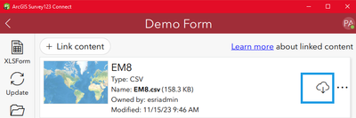

Step 4. In S123 Connect, along the bottom row of buttons, click "Linked Content" > click "+ Link content" > click "CSV" > search for and click on the CSV you uploaded in Step #2 > Click "OK"
Step 5. Click the "download" button next to the newly linked CSV

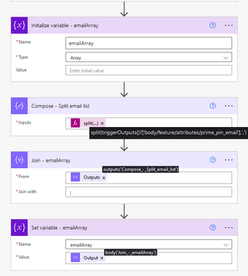

Step 9. In Power Automate, set up a flow with these steps

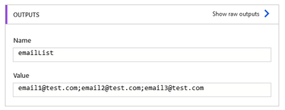

Result: A nicely formatted email list! Use this variable in your email's To field.
NOTE: Yes, you could replace the commas with semicolons and skip a few steps. Personally, I transform data a lot and use if for different purposes, so I figured I show the steps needed to complete this task and leave room for expansion.

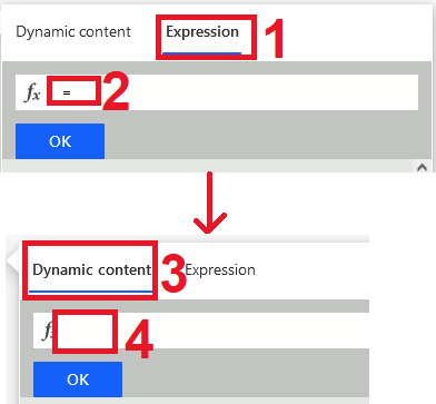

EDIT: Important Power Automate note... Sometimes Power Automate can bug out, and valid/published fields may not be visible. Do this to bypass the bug and show all fields: Click "Expression" > type "=" > click "Dynamic content" > delete the "=" > scroll through the list and find your missing field (you CANNOT type to search when you do this fix, you must scroll)
