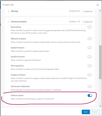

Hi Sara,
What role are your users assigned? In order to run a report, they need to be either a User, Publisher, Facilitator, Administrator or have a custom role with the following privilege enabled:
Can you confirm which role your users have?

@rwrenner_esriIs that AGO? When I go to Manage Rolls, I have a very different appearance in both Enterprise 11.0 and 11.1. In either case, I don't have "Premium Content". I've been looking for more fine-grained control over custom users...

Yes the above does refer to AGO. I don't see any mention of this exact privilege in the Enterprise docs, not sure if that's by design.
If I understand correctly, the survey is hosted in AGO and the survey and template items are shared through the distributed collaboration, and users in Enterprise are accessing it via the distributed collaboration group - can you confirm?
