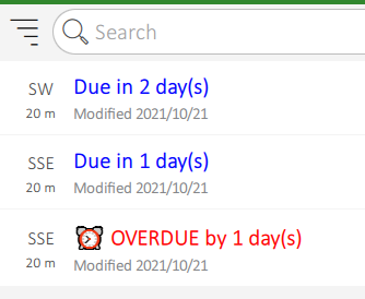

DeonLengton
I attempted Philip's last provided option:
Outcome:
I calculated the "age" of a feature with:
int(decimal-date-time(today()) - decimal-date-time(${ExpDate}))>0
Then used an if() statement in the Instance Name setting to alter the coloring of the text:
if(int(decimal-date-time(today()) - decimal-date-time(${ExpDate}))>0,
concat("<font color='red'>OVERDUE by ",int(decimal-date-time(today()) - decimal-date-time(${ExpDate}))," day(s)</font"),
concat("<font color='blue'>Due in ",-1*int(decimal-date-time(today()) - decimal-date-time(${ExpDate}))," day(s)</font"))
Ive attached the XLXS file for your convenience

DeonLengton
Outcome:

neomapper
Is there a way to sort by most recent date? Dates seem to get scrambled in the inbox
