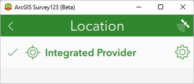

In Survey123 have you chosen the Integrated Provider? When you are using an app to add RTK and then make that corrected position available to other apps via mock location, you need to have Survey123 configured to use the Integrated Provider (instead of connecting directly to it with bluetooth).

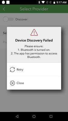

I use integrated provider. Survey123 doesn't let me use Bluetooth. I tried on several devices but it pops same error.

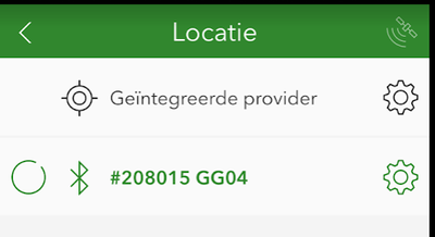

As a handheld we use a Panasonic FZ-N1 (android 8.1.0) with leica zeno connect (3.4.2.0.1850) and Survey 123 (3.13.244)  , and as a RTK we connect to Flepos .
* Now on the Leica FLX100, I get bluetooth metadata in S123
* But on a Leica GG04 with same settings , no RTK data is coming in ,  or the bluetooth doesn't connect , or the Leica zeno connect app crashes .

I got feedback from Leica: The NMEA metadata is only forwarded by the 'GG04 plus' , ... we have the GG04, .... so this won't work .
