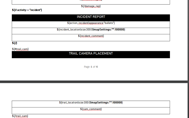

Hello,
I am looking for a way to hide repeats, with no data collected or that are not triggered, in a report generated from Survey123 data.
Presently I am using ${if activity=="incident"} and then ${/} to hide data that is in groups but I can't seem to hide conditional data that is in the form of a repeat this way. The template still shows up, blank, but still there with the header nonetheless and thus, as this is a long survey, generates a lot of wasted pages.
Would the solution be to turn the repeat into a group and then have the repeat within the group? (If that makes any sense?)
Any hints would be greatly appreciated!
Emily

Hi Emily,
It sounds like you want this comparison check:
${if (repeat1 | getValue:"count")>0}
Note that repeat | getValue:"count" will return the number of related records attached to the form
