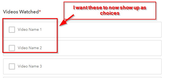

I am creating a Dashboard to track users watching safety videos.  When a user selects a "season" and a piece of "equipment" they are presented with a multi - select that allows them to click which videos on that specific piece of equipment they have watched.  Then they submit the survey.

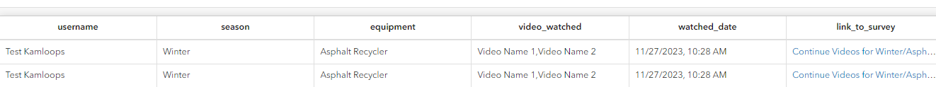

Subsequently, in my Dashboard, i am showing this information, but would like to provide them with a link to the survey - with most of the data already filled in.  I have accomplished this using URL parameters, but what I cannot figure out is, if they watched video 1 and video 2 on a certain piece of equipment, how to eliminate those choices on this newly linked URL?  So they can only select videos they have not already watched and acknowledged.
As you can see from above in my Dashbord Table - i have a URL created using this syntax:
?field:username=" + f['username'] + "&field:season=" + f['season'] + "&field:equipment=" + f['equipment']
but is it possible to have the Video 1 and Video 2 eliminated from my form as choices when it opens?

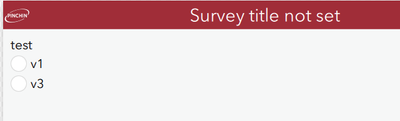

Result:
Just dump a comma delineated list into your hidden field. (EDIT: Do this in place of the "default" column I have above. Don't put anything into "default" when you do this)
EDIT2: I realize that this is technically the opposite of what you are looking for. But using this as a base, you can use either calculates (such as nested IF( ) statements) or JS to achieve the desired reverse outcome.

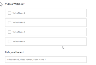

Thanks you for the replies and ideas.  I am still not sure how this applies to my URL parameter.  My original list of videos that are in the "Videos Watched" multiselect question are coming from a CSV - which is generated dynamically, so I don't necessarily know what the values are going to be.  But I have figure this out and populated it with my URL parameters - just not sure now how to filter the "Videos Watched" to not equal a value in the "hide_multiselect":
So basically, based on the above, i would like to hide Video 5, 6 and 7 from the choices.

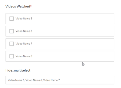

My URL to populate the image above is suffixed with this:
https://survey123.arcgis.com/share/{MYAGOLID}?field:hide_multiselect=Video_URL_5,%20Video_URL_6,%20V...
Which populates the "hide_multiselect" text box - but then in my XLS form - the choice filter for the "Videos Watched" question would be
selected(${hide_multiselect}=hidemultiselect) ??  This doesn't really make sense to me?
