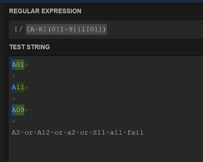

Regex 101 is a great resource for writing and testing regex.
I notice one issue with your expression, which is the "[01-11]" bit. Regex 101 gives the explanation:
Match a single character present in the list below
[01-11]
0 matches the character 0 with index 4810 (3016 or 608) literally (case sensitive)
1-1 matches a single character in the range between 1 (index 49) and 1 (index 49) (case sensitive)
1 matches the character 1 with index 4910 (3116 or 618) literally (case sensitive
To match the numbers 0 - 11 with a padded zero, we can write "(0[1-9]|1[01])". This will match a 0 followed by anything from 1 to 9, or a 1 followed by a 0 or a 1.
Secondly, there's really no need to have the {1}, as regex will by default only match your bracketed range of characters once. So the full expression would be
[A-R](0[1-9]|1[01])
You can see that those other cases all fail to match:

DavidTipping-Jsy
Thanks Josh - It worked a treat
