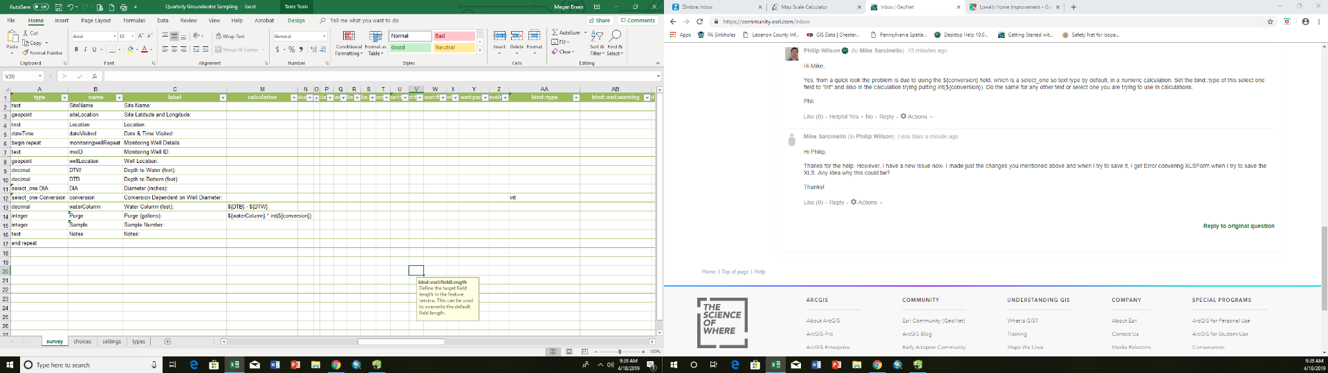

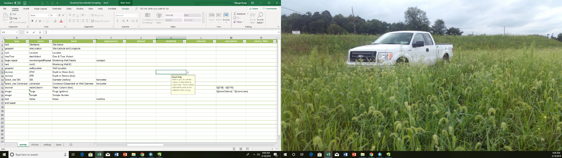

MikeSarcinello
(ignore the truck, it's dual monitors). Here is my xslx file. I'll try to mess around with the bind type column. Let me know if you notice anything else that could be going wrong, thank you!

MikeSarcinello
Hi Philip,
Thanks for the help. However, I have a new issue now. I made just the changes you mentioned above and when I try to save it, I get Error convering XLSForm when I try to save the XLS. Any idea why this could be?
