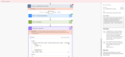

I am running into issues in the Do Until > Parse Json – Result Info step. It appears that it is the *Content Body option that is throwing this error. I currently have this set to Body (HTTP – Get Job Status). I have tried setting this to another Body file and the script will run through completion, but always results in the failed email. Has anyone else experienced something similar?
