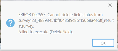

I have 2 status fields in a survey I created using web designer. I have removed one of them from my survey and would like to delete it from the feature service. When I go to the Table or Fields view in ArcGIS Online I do not see an option to delete the field. When I bring it into ArcGIS Pro I receive the following error when I try to delete the field:
What am I doing wrong?
