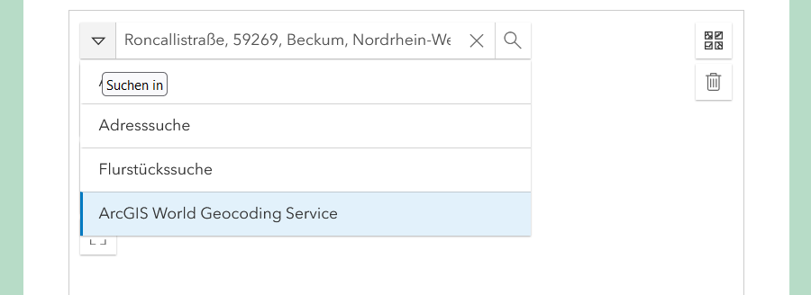

Thank you very much 🙂 With one geocode-service I got a solution. The problem is:
We have 3 geocode-Services:
We have "Adresssuche", "Flurstückssuche" and "ArcGIS World Geocoding Service".
I wonder how I could get a result from "ArcGIS World Geocoding Service" (so far, I get it from "Adresssuche").
KaiBehncke
Ok, I found a solution: pulldata("@geopoint",${location},"reversegeocode.address.Match_addr","https://geocode.arcgis.com/arcgis/rest/services/World/GeocodeServer")
