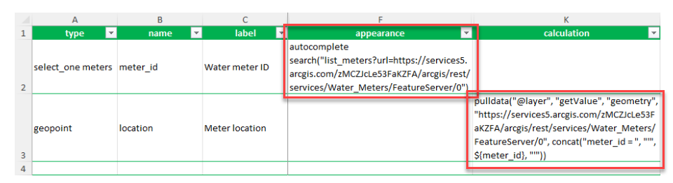

I have a survey developed in Survey 123 connect where I need to get the location from a list. This list is a question that asks for the parcel ID number and I need it to locate the parcel in the map.
I tried to use this pulldata function but did not get results:
In the first image I highlight that I use the autocomplete function in the appearance column and it is working fine, however when I place the pulldata function in the calculation column I don't get any geometry in the map.
I am going to leave the survey file in case someone can help me. I would appreciate it very much
ZacharySutherby
Hey @DanielLeón81
For the location question the question type will need to be geoshape instead of geopoint. Here's a sample XLSForm that shows it with U.S States as the polygon layer
