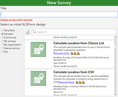

You can find 2 examples of populating the geopoint question from the Survey123 Connect's samples.
Base on your description I would suggest the 'Calculate Location from CSV' method.

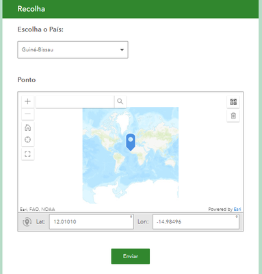

However, when i erun the survey the result is this
It put the right coordinates, but in the text box inside the geopoint element doesn't show anything and it does not zoom to the point.

 Yes, i am using survey123 connect, and i am viewing in a web browser. What i was expecting was to see in the texto box the coordinates, like in the example. which i don't. However, if i go to the map it zooms to the coorrect place. I was hoping the same kind of behaviour liking writing the name in the box. Meaning, close to the "+" appeared the coordinates like in your previous post

It plot in the right place, but as i said before in the text box of geopoint doesn't show the coordinates and it does not zoom.

Sorry I can't think of any other reason causing this. For me, using the example in Survey123 Connect and the coordinates you provided, the geopoint question in Survey123 web form zooms into the right location with populated values in the coordinate textboxes.
