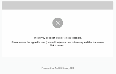

I've just tried logging in to the Survey123 website and it is showing the following error when I try and open my surveys:
Because of this, I can't perform Step 2.

I get the same error message when opening up in an incognito window. The error occurs literally just clicking on the survey form icon from the My Surveys page (https://survey123.arcgis.com/surveys). For a split second it shows the Overview tab of the survey but then displays the error. I.e., when it is trying to open https://survey123.arcgis.com/surveys/[itemid]/overview. Just to reiterate, we don't use this survey form in the web app. It was designed to be used in the field app.
DataOfficer
Hi @alison_gou , further testing shows this latest error (The survey does not exist or is not accessible) is affecting multiple forms related to multiple feature services and so I have raised a support case, as this appears to be a wider issue (perhaps related to the 3.13 release).

alison_gou
Hi @DataOfficer ,
The reason why I asked is because there has been similar issue raised. The issue being audio question would stop survey from loading properly.  Based on your reply, I think you were experiencing this issue.
However, it has been fixed and your survey with audio questions should be open properly now.
Regards,
Alison
DataOfficer
Thanks Alison. It does appear to now be resolved.
