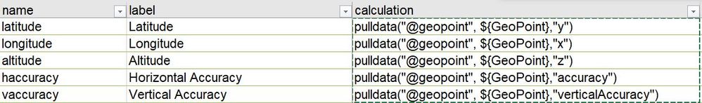

DataOfficer
@CrystalCowardin do you mean the x and y values? You can store these as separate fields by adding rows to your xlsform with pulldata calculations. E.g.
where ${GeoPoint} is the name of your GeoPoint field.

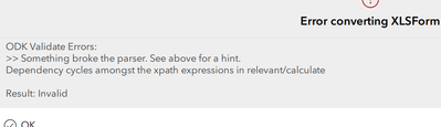

CrystalCowardin
pulldata("@geopoint", ${LimitedBroadbandLocations_v02_point}, "y")
This is what I've put in and keep getting this error when saving the form.
DataOfficer
What do you have in the relevant column for that row?
CrystalCowardin
I didn't put anything there.
CrystalCowardin
I had the calculate in the wrong field! Trying again.
