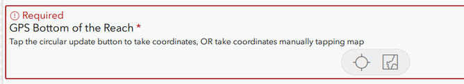

I have a similar case where the user needs to take several geopoints and we want to make sure they re grab the GPS when then get to the second or 3rd sport so not all of them are the same.  We also have some crews open the form while still in the truck and then the geopoint is wrong.
I do this by setting the default column of the geopoint to 0,0.  Then I make it required.  This then stops the user like this.
This idea may work for your issue.
Other Idea is to do a pulldata on the geopoint and get the x and y then check those for 0. pulldata("@geopoint", ${GPSBottom}, "x") != 0  You are saying you tried this but my guess is you used calculate instead of decimal type.  That gives you a string.  Try decimal then you can use an appearance of hidden to hide it.
You may even be able to use a constraint in the geopoint of . != 0,0 but no idea of that works.
Hope that helps

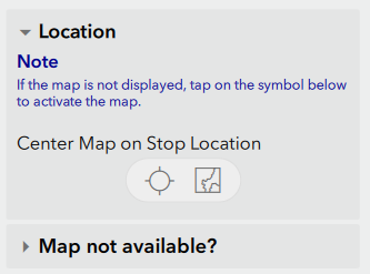

I think that the reason some of my users submit a zero-zero lat/lon is because they don't tap on the update map symbol:
updateMapSymbol.PNGI think previously the iPhone app would display the map by default, not these symbols. (It seems like Survey123 is a bit of a moving target.) Yesterday, I added a conditional note to tell users to tap the symbols to display the map. This note is only displayed when the latitude is zero. I also have a "Map not available?" group to handle the situation if the map can't be displayed. In that case, they type in a description of the location.
updateMapNote.PNGI check for a zero latitude with either of the following calculations:
Text (check to empty string): pulldata("@geopoint",${MyGeoPoint},"x")
Decimal (check for zero): round(${LatitudeText}, 5)
When I say decimal above, I'm setting the bind::type column to decimal.
