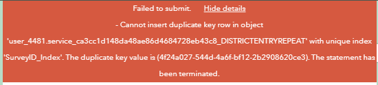

I am struggling to get both requirements met. If I set the unique ID column calculation to uuid(), then each repeat gets a unique value, but the repeat's UUID change every time the submitted survey is opened in the future. If I set the calculation to once(uuid()), then all repeats get the same UUID during that session.

I see. I would definitively make the field as text and do not apply a unique constraint in the database.  Please make sure that the target field where you will store the value is also a text field type. If you keep the field hidden in the form, users will not be able to change the value manually and the ID will not change when survey sends the data.  I think your workflow will work well as you describe it.  Just make sure you treat your ID as text.  The visibility of the field does not explain the unique constraint message you are getting. That is caused by a constraint in your database that you want to remove.

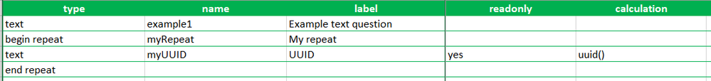

Hi. If you add uuid() into the calculation of a question within your repeat, a unique id will be created for every record in your repeat. This value will not change (the calculation will not be triggered) when you reload the data into the survey.

After some additional testing, I seem to only run into the issue of duplicate keys if I have the UUID field hidden, and not set to the text data type (I have a unique index on the field to be used in a reconciliation process later):
Once I set the data type to text (read only) and republished, I am seeing the UUID field behave as expected- meaning I get a unique ID on each record, and they don't change when the survey is submitted and re-opened.
