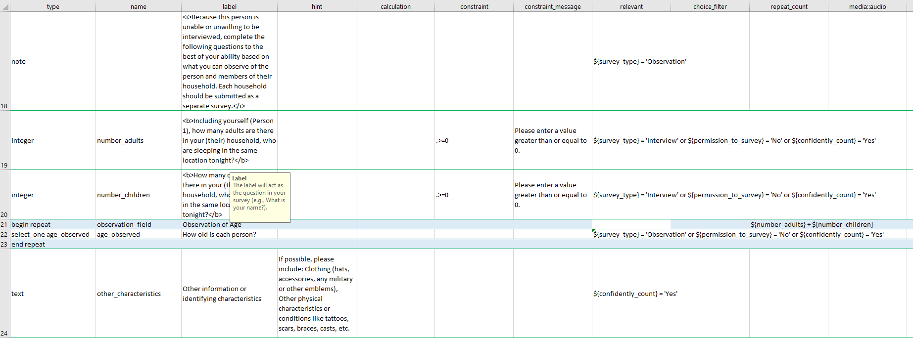

I'm trying to develop a survey with multiple repeats. It works fine in Survey123 Connect, but when it's published and I try to use it in a web browser, it displays the following error message.
  • FormLogicError: Could not evaluate: /model/instance[1]/Form_3/survey_type = 'Interview' or /model/instance[1]/Form_3/permission_to_survey = 'Yes', message: Failed to execute 'evaluate' on 'XPathEvaluator': parameter 2 is not of type 'Node'.
None of the repeats are working or showing in the browser. All work in Survey123 Connect before it's published.
Any help would be appreciated.

Hi @alyssajhnsn  You will need to share your XLSForm for anyone to be able to help you. If you do not want to post your XLSForm file publicly in this forum, our Esri Technical Support team will be happy to help if you open a ticket.
alyssajhnsn
Attached.
JenniferAcunto
Why do you have ${survey_type} = 'Observation' or ${permission_to_survey} = 'No' or ${confidently_count} = 'Yes' in the bind::type column? If you are trying to control when the repeat is displayed you need to use the relevant or the body::esri:visible columns.

I honestly was trying to move it around between relevant and various places trying to get it to work. I opened a tech support case and rebuilt the survey from scratch. It's some issue with having calculations or anything in the repeat_count column for the repeats.

@alyssajhnsn  While there are some issues in the Survey12 design, as highlighted by @JenniferAcunto, the fundamental problem is caused by what looks to be a BUG in the software. We are still investigating the root cause. At first sight it seems to be related to the combination of repeats, with repeat_count, relevant statements and the minimal appearance.
I suggest you open a Tech Support Incident so this is logged more formally. We will continue researching on our side to understand the problem better.
IsmaelChivite
Esri Notable Contributor
@alyssajhnsn   We made some progress with this. The software defect is logged as
BUG-000153480 If a question outside the repeat is using the same relevant expression as a begin repeat with minimal appearance, the ArcGIS Survey123 web app 3.16 returns the error message...
We are aiming at addressing this in February 2023. In the meantime, avoid repeats with both repeat_count and a relevant expression.
I made minimum changes to your design to get it going. See the file attached to this message. I removed the repeat_count.  As an alternative to repeat_count, you could build some logic to display a message if the number of records in the repeat does not meet criteria. You could also use a constraint, on top of the warning note, to make the collection more robust.
