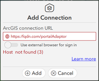

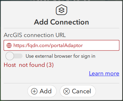

The issue was that the second double slash (highlighted below) was being truncated automatically by Outlook.
https://survey123.arcgis.app?itemID=892c04cfda4144ebb1c06d6eae6af137&portalUrl=https ://fqdn.com/portalAdaptor
Resulting in this screen (notice the missing / )
