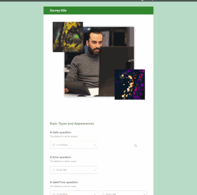

Thanks for sharing this. The bug you mentioned is caused by a question being placed outside of a group with the field-list appearance, which is not supported usage as outlined in our documentation: https://doc.arcgis.com/en/survey123/desktop/create-surveys/xlsformsappearance.htm#ESRI_SECTION1_8BFD...
If you need to place the image ahead of pages, please change the name of this note to "generated_note_form_title", and move the image link to the hint column. This will change the note to a form element, and the hint of this note will become the description of the survey. https://doc.arcgis.com/en/survey123/desktop/create-surveys/xlsformnotes.htm#ESRI_SECTION1_31E80EF0A3...
Here is an example:
If this is not the issue you encountered, could you please share a sample XLSForm with us so I can investigate further?
