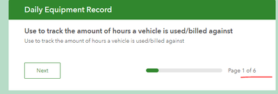

Ruth_JiatengXu
Hi @KarimNaguib
Here is the form I published, and it looks like the following:
Could you please help double-check your form?
1. All questions except generated_note_ should be wrapped in group or repeat with field-list appearance
2. Change the name of your note question "Use to track ..." to something else.
Or could please you share your XLSForm with us, then I can help you check.
Thanks for your patience!
Bests,
Ruth

Ruth_JiatengXu
Hi @KarimNaguib ,
I modified your XLSForm a little bit, and this should make your form works as expected in the web app.
I wrapped the generated_note_surveyDescription question in a group with field-list appearance (I highlighted the places I edited). The web app always rendered the generated_note_surveyDescription question as a separate cover page for the multiple-page survey, so it should be wrapped in a field-list group for the multiple-page survey.
I guess your survey is published from the website as a single-page survey, so the generated_note_surveyDescription question does not work as expected.
Please let me know if you have any other questions!
Thanks,
Ruth

Ruth_JiatengXu
Hi @KarimNaguib
Thanks for your reply! If you don't want to see the description on a separate page, please change the name of your survey description to something that is not "generated_note_surveyDescription", and move the note question into your first page group. Then the survey description will be rendered as a normal note question instead of the survey description. I have attached another modified form here, please ignore the warning "question has no label", and it is ok for the page to have no label. (We can skip warnings but not errors).
To make it more clear, it is the by-design behavior of the web app to display the survey description (generated_note_surveyDescription note question) as a separate page. If you still need to have a survey description and you want to see it together with your first page content, please let me know.
Thanks,
Ruth

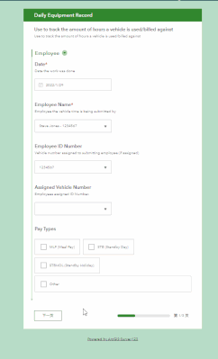

KarimNaguib
Thank you Ruth.  I just tried the form that you sent, and on the web form I ended up with a 6 page survey rather than a 3 page survey.  It ended up creating a new page for each of questions on the first page (on the web form only).
Thanks,
Karim
Ruth_JiatengXu
Hi @KarimNaguib
Bests,
Ruth
KarimNaguib
Thank you Ruth.  I have changed the survey quite a bit since I first posted, but it does seem like these changes will resolve the issue.  Thank you for taking the time to respond.
