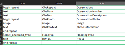

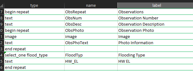

I have some image uploads (Image) that are nested in two repeats (Observations > Observation Photo). I am trying to figure out how to retrieve the URL to get the images in Power Automate (Flow). I cannot seem to find the URL field in the Dynamic list in Power Automate.

@DeonLengton Hello Deon, Yes, it works fine for me when I don't have the attachment in repeats so the post didn't help in my specific situation. But I figured out that I have to use an Apply to each for each repeat used , then one more Apply to each with the attachment field itself, and then I could find the attachment URL to do what was needed.
