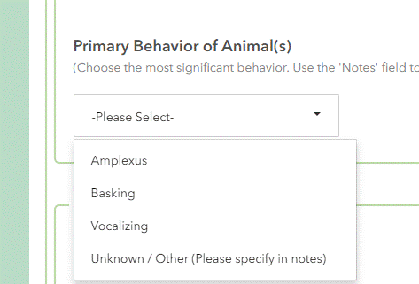

Hello,
I am trying to get back to using webforms as an alternative to using the field app since the S123 team has resolved some major issues in the past few months. However, I am running against a previously unidentified issue where choice filter values (e.g. in the field "lifestage") that are dependent on another field (e.g. "species name") are not displaying when I first select a species. However, once I change the species name, a second time (even the same species that I initially selected), the fields with choice filters do show properly. The pictures below show this process. I do have a workaround where if I set a default value on species name (in Connect), the choice filters will show values for that default species. This is inelegant and would also mean that I would need a separate form for web use that is slightly different from a form created for field app use, so any solutions (or better workarounds) would be great to hear.
Thanks,
Treg
1. The initial species name (which populates a hidden species group field, e.g. "amphibians")
2. Behavior field doesn't have any values, after clicking on dropdown arrow
3. (not shown) reselect a species name
4.behavior choices for amphibians do show up in the behavior field

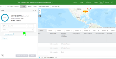

AndrewMcDonagh
Hello @JamesTedrick ,
I recently encountered this problem after the oct. 25th update. My unique values are not showing up.
We have 23,000 submissions to our survey - park rangers pull the # of programs each ranger submitted for the month and have for the last 16 months without this issue.
Now when a Ranger goes to the Data or Analyze pages, chooses filter and the field Presenter Last, First name - clicking Unique, all the Rangers names to choose from are not there.
I have tested in Chrome, Firefox and Edge on both Analyze and Data pages.
You can see this working correctly on this video here https://www.youtube.com/watch?v=BOsmw8PU2vk&t=2s
Do you have a work around?
Thanks!
