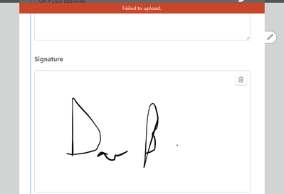

@BarbaraWebster1 I seem to be encountering a new issue I didn't have before since publishing today... I'm unable to submit Signature attachments to an existing record (edit parameter on survey) -- I get an error "Failed to upload" could it be related to the update? I can successfully update all the other fields and submit the survey, just can't submit the Signature. Could be unrelated but the timing is suspect...
Thanks!
BarbaraWebster1
Hi @BrittanyBurson,
I just tried submitting a signature question in the web app while using the mode=edit URL parameter and didn't run into the error. If this survey was published from Connect do you mind sharing the XLSForm so I can see if I can reproduce the error you're seeing?
Thanks,
-Barbara
