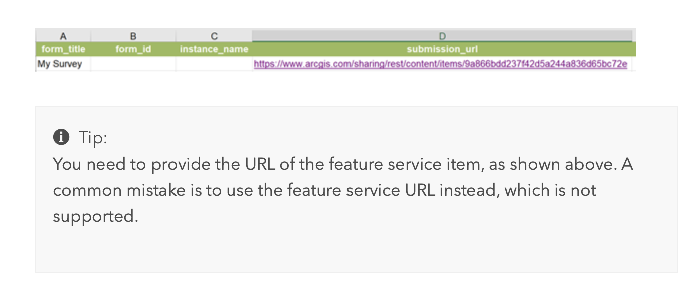

Hi Sarah,
It looks like you are using the feauture service URL instead of feature service's item:
Use Survey123 with existing feature services—Survey123 for ArcGIS | Documentation
Pay attention to the url link, it should be https://<your portal>/sharing/rest/content/items/<your_item_id>
