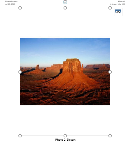

I'm having trouble getting the Feature Report to properly size the photos.  I'm trying to fit two photos per page so I've restricted the width to 500, and maintained the aspect ratio using this syntax:
${ photo | size:500:0}
However, the output Feature Report seems to be reserving a ton of white space at the top and the bottom of the photos which only allows for one photo per page.  Did something change when the new site was launched that might be causing this?

Thanks for sharing the files. The reason why you have white spaces is because the "appearance" column of the image questions in xlsx form is set to "annotate", which will capture the whole device screen and upload that as the image. This is useful when you want to add annotations (drawings, text watermarks etc.), but if you don't need to add any annotations then just delete the annotate appearance and this will upload the original image files.
