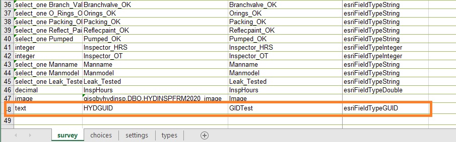

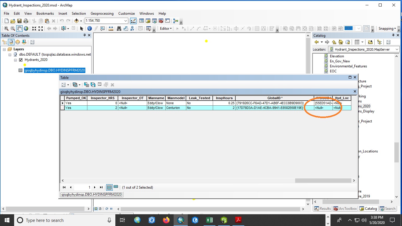

I am able to open Survey 123 from ArcGIS Collector and add a record in the related table.  The problem I'm having is that the record added to the related table does not populate the GUID field in the related table (see image below)
This is an image of the XLSX sheet in Survey 123 showing the type, name, label and field type for the GUID field in the related table
This is the URL passed to the popup in Collector to open Survey 123 from Collector:
arcgis-survey123://?itemID=9c24cd21569440f8b442d412781144fe&field:ParentGlobalID=[HYDGUID]
The record is added to the related table but the GUID is not populated.  Attachments are also added but are not linked to the feature layer.
I'm not sure what I'm missing that will allow me to add the GUID to the related table and have the related record linked to the parent feature. I am able to successfully link the two tables and populate the GUID field in Collector when NOT linking to Survey 123.
Supports ApplyEdits with GlobalIDs is true in the feature service.

After working with the URL config a bit I was able to get the result I wanted. Based on your XLSForm I would suggest you try the following URL in your pop-up configuration:
arcgis-survey123://?itemID=9c24cd21569440f8b442d412781144fe&field:HYDGUID={GlobalID}
What this is essentially doing is telling the survey, when launched from collector, to populate the text question for HYDGUID in your survey with the GlobalID of the feature you have selected in Collector. The {GlobalID} at the end needs to match the GlobalID field name exactly how it is in the feature service for your Hydrants layer. I had to set mine to lowercase based on how it is listed in the rest service.
