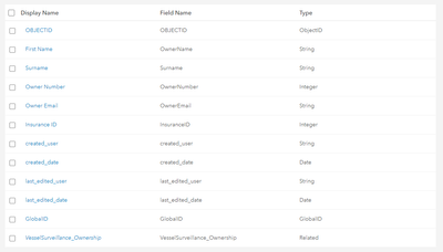

As you will see I have not configured the GlobalID in the form, I would expect the GlobalID to generate automatically when a new record is created, however it seems to be trying to convert the field to an int.
The following image shows the schema with the GlobalID being and GlobalID type field

Hi @AnaisSchanzel,
Are you using AGO or Enterprise? How was the feature service created and published?
If you openthe same survey in Survey123 field app, can you submit successfully?
Do you have related tables in the feature service? How were the relationships created? It appears yours survey XLSform does not have any related tables (repeats) so is the survey pointing at the parent or the related tables (via the submission_url)?

AnaisSchanzel
Hi @Anonymous User
AGOL is being used. The feature service was created in ArcGIS Pro with relationships and published to AGOL.
When trying on the S123 field app it also results in an error.
Yes this table is related to another table with a one to many relationship. The relationship was created in pro and the survey is pointing to the parent table.
The survey just requires editing of the parent table and not the related table at this point.
