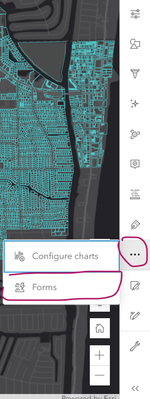

This document provides guidance on setting up a spatial query using the web designer. Curious whether you're seeing it not work after configuring it or whether you're still in the process of setting it up?
While I'm not sure the exact differences in how the web designer and Survey123 Connect query layers, I do know that using the pulldata("@layer") calculation method in Connect which serves the same function in the field app is known to not work offline. The pulldata("@layer") method is described with examples here. (Note: once you bring a survey into the Connect editor you can no longer edit its configuration via the web designer, so I'd recommend using a test survey first.)
