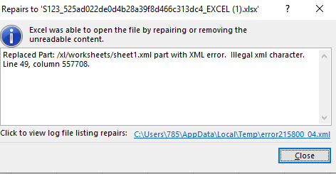

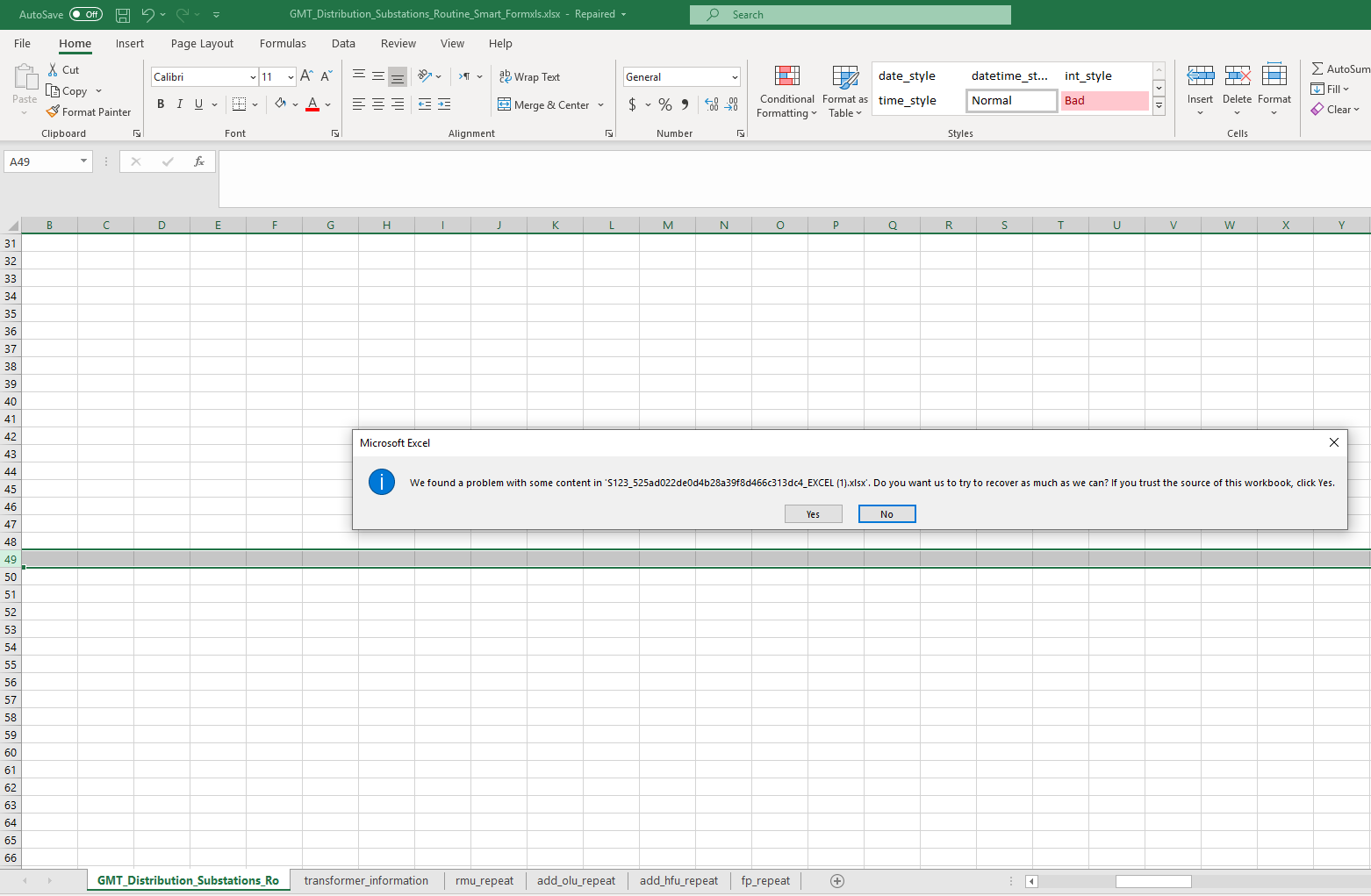

I am facing weird message when trying to export the Survey123 data (around 2847 records in main table) to Excel.
See the below figures of the issue. This survey contain related tables which are not affected but the only sheet has the issue is the parent table!
Also, when i tried to export a selected row and error returned that failed to export!
# in Survey123 Website:
# In portaladmin endpoint logs
Failed to export item 'S123_xyz_EXCEL.xlsx' (id:XXXXXXXXXXXXXXXX). null. Job ID: 'xyz'
The survey exported finely with CSV and SHP.
