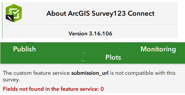

I just updated my Connect version to 3.16.106. I updated one of my surveys, just the constrain condition. But I cannot publish the updated form with 3.16 version.ConnectError.png
I installed the old version and I could publish it.
Can someone from the product team check the issue?

This has been posted and a fix is due out soon.  The RC versions that came out today in Early Adopter I think have the fix.  https://earlyadopter.esri.com/
See here for more info.
https://community.esri.com/t5/arcgis-survey123-questions/fields-not-found-in-the-feature-service-0/m...
Hope that helps

Thanks Doug for the reply and also the link to other thread.
By reading the other thread, the next version is due next week. I will wait for the next version and I will use the 3.14 for my immediate needs.
