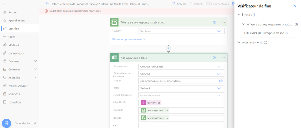

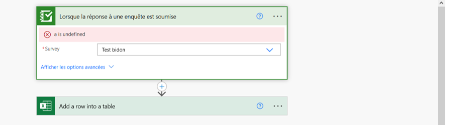

All existing flows between power automate and survey123 are functional. But, it's impossible to modify them because of this the error message : "a is undefined" (see picture).
If i create a new flow, i have this error message :URL d'ARGuis is required, and so its impossible to save this flow (see picture).
Thanks to the communityURL arguis not valided.pngURL arguis not valided.pnga is undefined.pnga is undefined.png

This is a defect with the Survey123 templates in Microsoft Power Automate. This has been logged as BUG-000155504.
To work around the behavior either remove the Survey123 connector and readd it or select My flows > New flow > Automated cloud flow and select the Survey123 connector.
