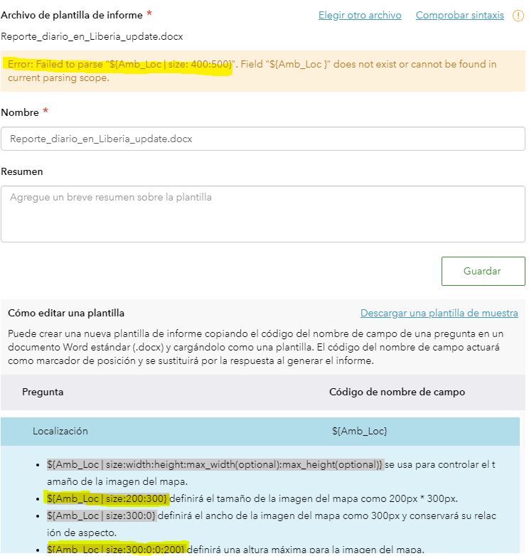

HaroldHerrera1
Hi James Tedrick
Many thanks! Now, It's work perfect!

HaroldHerrera1
Hello James.
Do you know why the error back, when I try to update the template, specifically with the photos and maps outs?
JamesTedrick
Esri Esteemed Contributor
Hi Harold,
Is Amb_Loc in a repeat or being referred to in a repeat section?  Can you share the template with me (e-mail jtedrick AT esri.com).
HaroldHerrera1
Hi James.
The place inside the template {#Amb_Loc} and {/Amb_Loc} was wrong. My mistake.

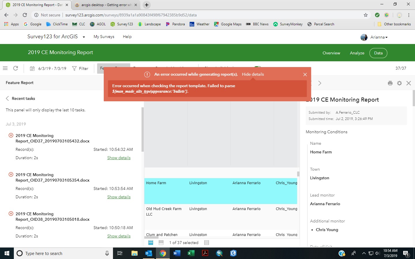

ChrisYoung2
I am having a similar problem. Last week my assistant could generate reports from the website fine and this week she is getting an error message (see below). I found that I can generate the reports fine. It also seems to be isolated to only this template. Any ideas of what is going on?
ChrisYoung2
Correction, I can't generate this report either.
