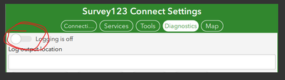

Have you tried enabling logging, in settings underneath the diagnostic tab.  That might help pinpoint the issue.  Also if you can, sharing the xlsx may help.

I have opened the diagnostics tab and it continuously is 'Searching for AppStudio consoles' should this be the case?

You have to toggle on logging
The tell it where the log file should go.

Thank you for the clarification, I did this. But unfortunately it still is preventing me publishing with a blank Critical Error!

Did you look at the log file? If you can upload it, it would help. It should be in the location you set when you turned on logging.
