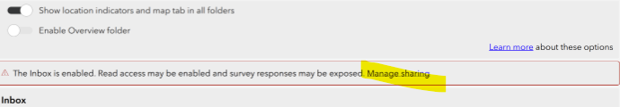

Did you check the Share Setting on the collaborate tab on the survey123 site?

EmilyGeo
Hi @SumukhRamesh
how is the layer shared? It may be that the user does not have proper permissions. Survey123 share.png
SumukhRamesh
@EmilyGeo @Neal_t_k
Thank you for the suggestions. As pointed out, under Collaborate tab in Survey123, under the section "What can submitters do" the option was set to "Only add new records". I changed it to "Add and update records" and now the non-admin users are able to see existing surveys in Inbox and edit them.
Thank you.
