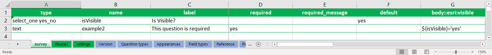

Hi. I did a very simple test on this using version 3.17. See below. Both the mobile and web apps behaved as expected. That is, when the question 'example2' is visible, it is required, when not visible, it is not required.
We will need to explore this in more detail with your help. Can you share your XLSForm? If not, you may want to open an Esri Tech Support ticket.
