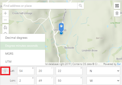

Hi @DaveK
It is possible to change the input format by selecting the marker icon to the left of the coordinates. The available formats include:
  • Decimal Degrees
  • Degree minutes seconds
  • MGRS
  • UTM
