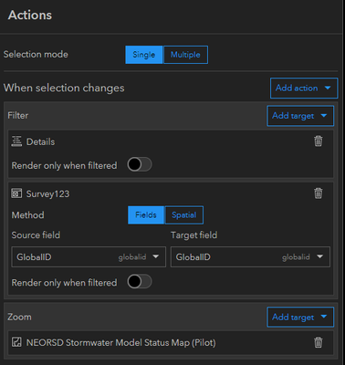

Thanks Everyone for your suggestions, they got me on the right track. First, I changed the Submission URL on the Editing Form back to what the default Submission URL that was created when I published the Editing Form (not sure if this mattered or not).
And then I noticed in Jamie's post that he had "Features" selected under type for the embedded Editing Form in my dashboard so I updated that and it did the trick.
Once, I did those changes my survey became available for actions, so when I select an item in the list widget, that record comes up in the survey (and map). Below are my actions under the list widget.

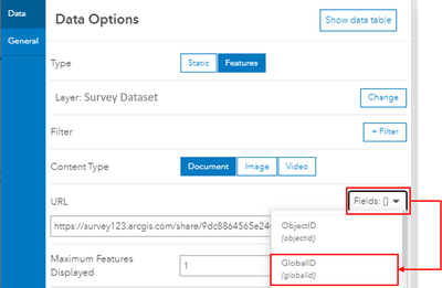

Hi @LJackson29,
If you manually typed the {globalid} part of your URL, try using the Fields:{} dropdown to select if from the dataset instead. I have had issues in the past when manually typing {globalid} that have been resolved this way.
Hope this helps!
Jamie.
