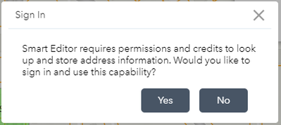

Looks like this issue is also affecting the SmartEditor Widget in Webapps.
