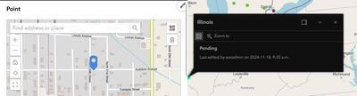

I have a few survey/web map combos that are set up like that, and i used one just 5 minutes ago (not the best picture, but the info is being passed from EB to S123 as it should):
This does seem odd.
