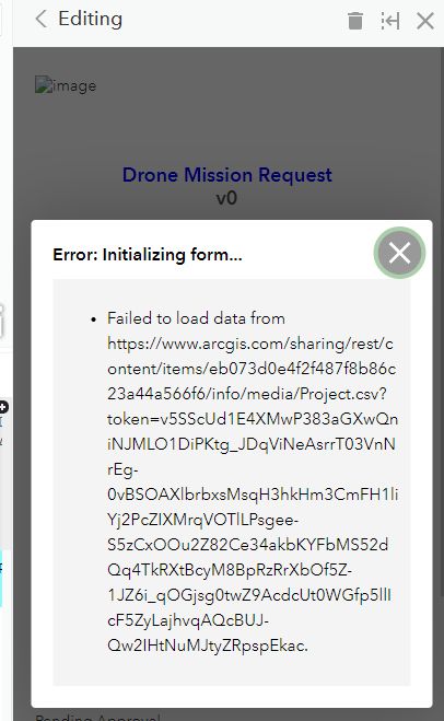

Also appears the form has issues loading the associated .csv file from the media folder when trying to edit:
Error appears after selecting editError appears after selecting edit
wcozzens
The .csv file is loading correctly now - user error on my part.
