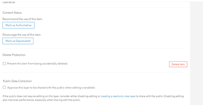

This is the selection I was talking about. but if you have to do a full assessment I think that makes my answer not applicable

Monika, that is great to know. I will likely use that setting when I do go live. Can you tell me where I find the setting? I don't see it in Survey123Connect, the Survey123 webpage or the feature layer page.

It is in the settings on the feature layer in the top section

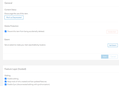

For some reason, I'm not getting that option Monika. Maybe that option is set at Administrator level?
